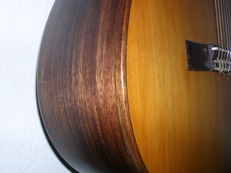

Here is one I did a while back in EIR. I used offcuts from the sides to try and match the grain. It's a bit tougher to do than you would think. It was a lot of fun and I plan to do more like this. In fact have one on the bench now. BTW that's a single black purfling line between the sides and bindings.
Don't mind the dust this one's been hanging on the wall for a while.
